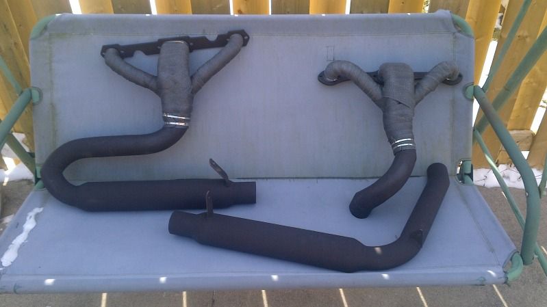

well since the weather was decent, and i'm itching to do something while the motor is out at the shop. i decided to coat the whole exhaust and wrap the headers:
