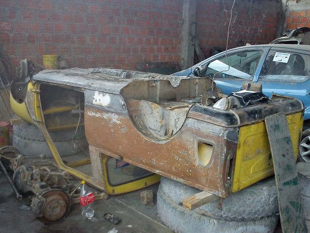

Project is underway. Here is one of the first pictures after I bought it. I let him keep his bumper. I didn't think about selling it as scrap.
I haven't had a lot of time to play with it because of business, and because I also ended up buying a Renault Ondine.
I'll be updating my site with all the progress as it comes, but here are a few shots.

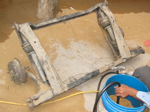

Rolled it over to pull the rear sub-frame to clean and paint, and start replacing the floor with panels from a donor Toyota minivan.
A 15 hp water hose will get it ready to sandblast

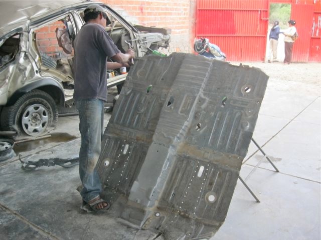

Not much happening. Project was stalled for a few months as my body guy had found a car he could use as a donor for panels. after wasting 3 months negotiating and actually traveling a long way to get it, the guy backed out.
So this will be my new floor, donated from a toyota minivan

« Reply #13 on: December 21, 2011, 09:47:38 AM »
Is that going to work?  Tunnel might be a little big?

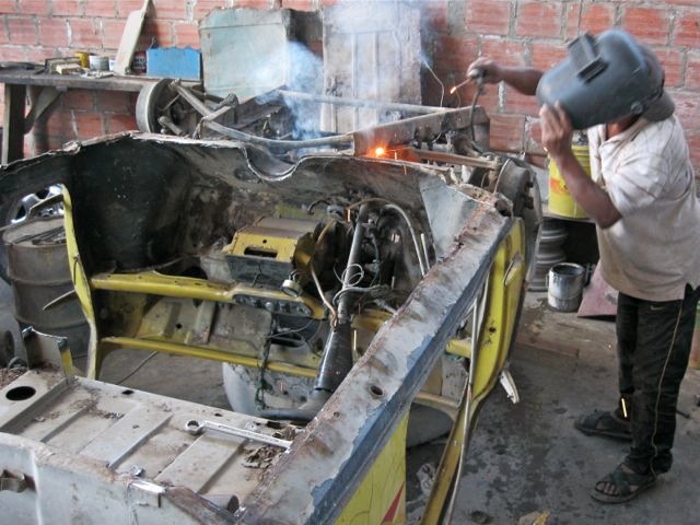

First was cutting out the entire floor and the modified front sub-frame.
Then forming and tacking the Toyota floor in place with the side panel he had formed from a donor car.

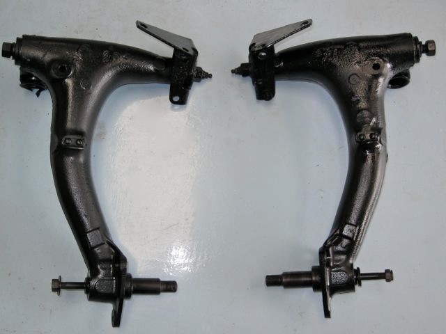

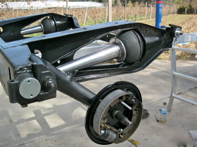

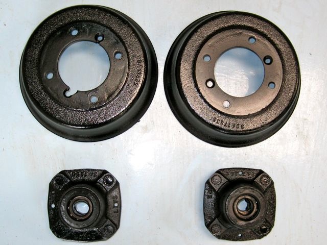

Meanwhile I took the rear sub-frame, sandblasted it and painted it and the rear brake drums that I will use. I also ordered a set of bushings and knuckles. I found out that my HS6 SU carb is from a 1800cc Chrysler Avenger, so I;ll have to see how it fits the 1275cc engine when it gets here.

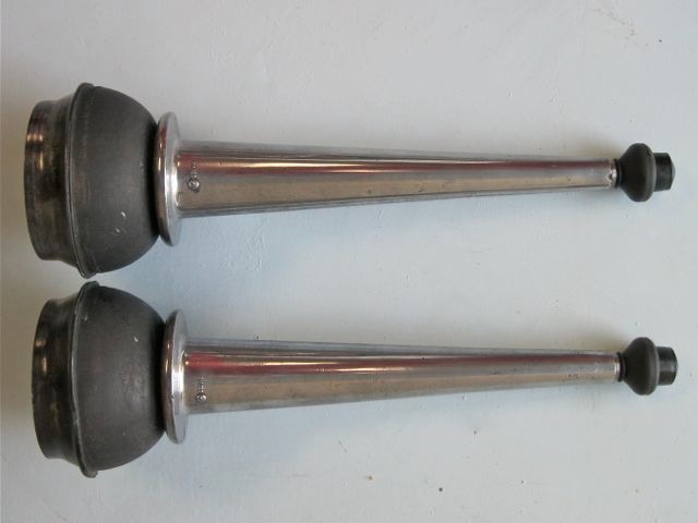

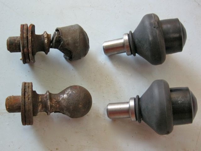

Got a couple of hours free this afternoon so I polished up the trumpets, put in the new knuckles and put things together. Going fine til I realized I hadn't ordered wheel bearings. Then realized my wheel bearings aren't like the ones in catalogs. (see other post for questions)

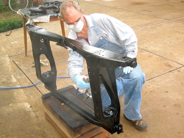

That guy decided not to sell, so found a front clip in Chile and my body guy went and got it. I've had a chance to clean up and paint the subframe and a few parts, then the rest of it got here, so we will fuse the front of a 94 Rover Mini to the rear of the 75 pickup, giving me the 1300cc engine, auto trans, AC, roll-up windows, etc.
