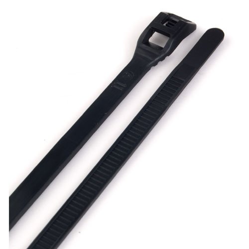

towjoe
Dave ,
I think you would like these............
From Amazon:
ACT AL-14-50-LP-0-C Cobra Low Profile Cable Ties, 50lb, 14-Inch, UV Black, Pack of 100
by ACT
Be the first to review this item
Price:   $17.66 & FREE Shipping
Regards
MiniDave
Thanks Joe, those were the exact ones I was looking at!
